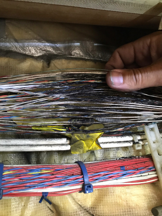

While chasing down a shorted power supply output for the DFDAU system, we came across this......

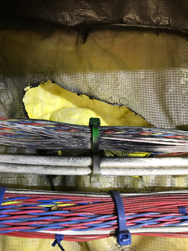

After cutting tie-wraps and spreading things apart, we could see that we were dealing with a serious arcing event.
Each wire in the bundle had to be cleaned and inspected.
In total, we had 7 unshielded twisted trips, 2 shielded twisted pairs, and 5 single conductor wires sliced completely open or showing signs of stress. 6 of the twisted trips were three phase power wires for the PDU's (Power Drive Units) used for cargo handling (we had six corresponding breakers popped on the forward lower cargo power distribution panel). Our DFDAU 28VDC accelerometer (power and return twisted pair) was burned in half.
The image below shows the damage to a couple of the twisted trips. The ends of these wires had metal globules that pretty much verified that they had melted.

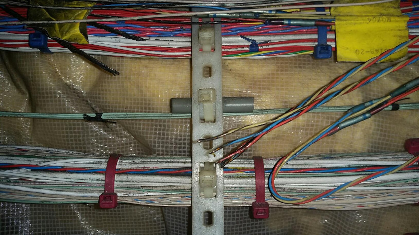

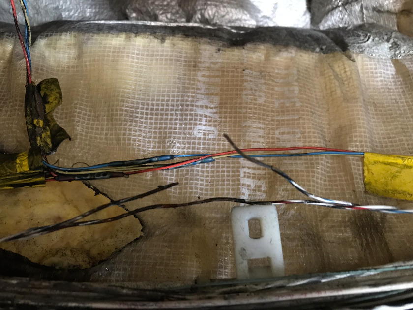

This image is poor, but it shows what I believe to be the culprit pair of wires. These two twisted pair wires had their insulation burned off exposing about an inch of bare conductor. The blue wire is open. The red was hanging on by just a few threads.
I think the blue wire exploded and sent out a "wedge" of heat and energy that damaged all the wires in its path. We didn't open up and examine the layout of the wires vs damage like we should have. The damage could have been circumferential, with all the immediate surrounding wires damaged. The fact that the red wire was still together leads me to think the wedge is more likely.
This wire pair was verified to be the power and return 26VAC excitation to the Right A/P Aileron Actuator LVDT (all right auto-pilot systems were inop and on deferral before we started our troubleshooting). It was the blue (power return) wire that let go.

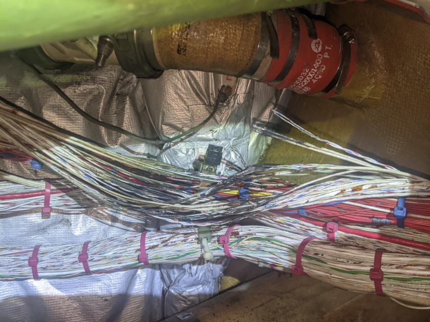

4 years 8 months ago - 4 years 8 months ago #785 by Mark
Replied by Mark on topic Kapton Wiring
Different aircraft. Same forward left sidewall.
Previous comments to people about issue..... ignored.
Any aircraft flying with Kapton wiring are ticking time-bombs.
What's it going to take before the problem is addressed?
