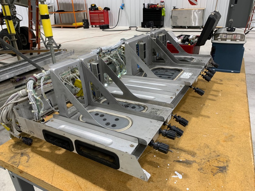

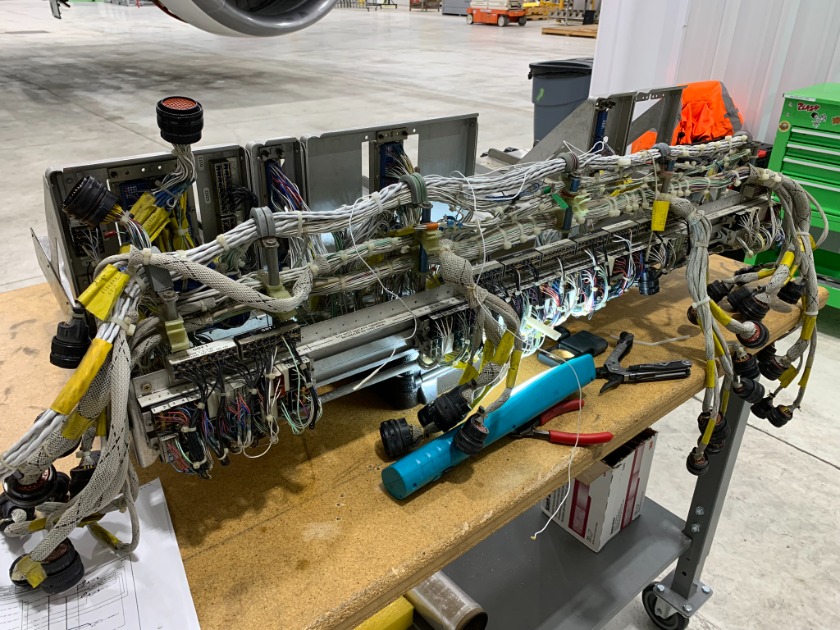

When a modification requires the rack to come out because there's just too many wire changes that need to be done.....
In this case, a ground strapping modification for the EGPWS call-out mode.
