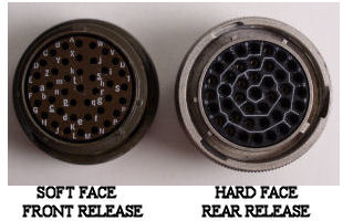

Front release plugs are found on older analog based aircraft. Newer generation applications use rear release plugs for most applications. Both types of plugs use locking tabs around each pin. The tabs must be spread open for the pin to be removed.

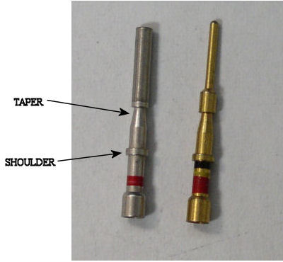

A quick visual of the front face is all that is needed to differentiate between the two. Front release will have rubber on the face and rear release will have a hard plastic material. Front release pins have a noticeable taper in diameter that starts after the shoulder.
The standard ranges of pin sizes are red, blue, and yellow. Red pins for gauges 18-22 receive the majority of use.

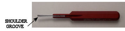

Front release plugs use a pin pusher tool to remove the pins from front to back. The tools are made by several manufactures, but they all work in the same fashion. A insertion tool with a shoulder grove is used for installing pins. (I tend to use the wire itself to push the pin in until it locks. This is not recommended for wire gauges over 20 as the wire tends to fold over the pin base.)

  1. Selection of the proper tool color is an easy task. The pin diameter will dictate which color to use. The possibility of a mistake is slim. When the tool is placed around the pin the fit should be snug.
  2. The tool should be inserted and fully seated around the pin. A definite stop will be felt. Pin push tools can be rotated left/right to assure a full seat is made. If the tool has not been placed properly, the locking tabs will not be expanded and the pin cannot be removed.
  3. Pin extraction is completed by pushing the plunger. If the pin has a wire, a moderate pull will help to remove it fully from the plug. If no wire is present, a stick pin or paper clip from the plug front will help complete the extraction. Grabbing the base of the pin with needle nose pliers from the plug back is not recommended. If the base is deformed, it will call for rejection of the pin.
  4. A pin is placed into the plug with an insertion tool. The tool will have a groove at the end that is designed to fit around the pin base. A small click will be felt when the pin is seated and the locking tabs engage. If the wire gauge permits, I will use the wire alone for insertion.

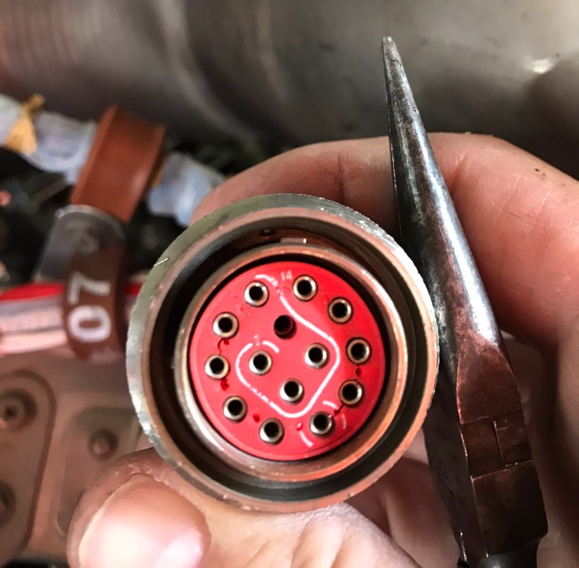

An unusual problem found with a front release plug..... plug internal rubber shift .
When these things let go like this, they just fall apart. We could rock the whole thing CW/CCW with a pair of needle nose pliers.
