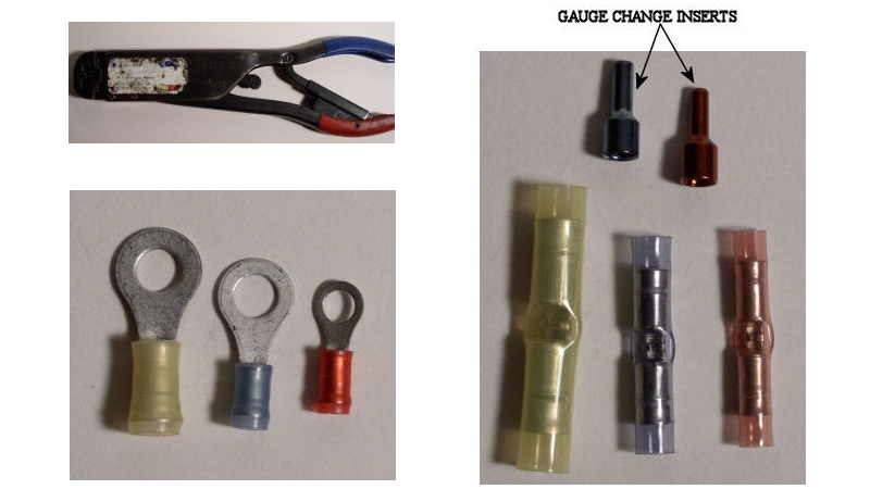

  1. Color codes for wire gauge are standard for all aircraft usage. Yellow 10-12, Blue 14-16, and Pink/Red 18-22.
  2. The inserts shown with the splices on this page allow for two different wire gauges to be connected together. The blue insert fits into a yellow splice and the red insert fits into a blue splice
  3. The tool, terminals, and splices shown here are commonly used on aircraft manufactured in the United States. Airbus® aircraft have a slightly different style and material for their terminals. A specific tool is needed for crimping these, but a double crimp is still the result.

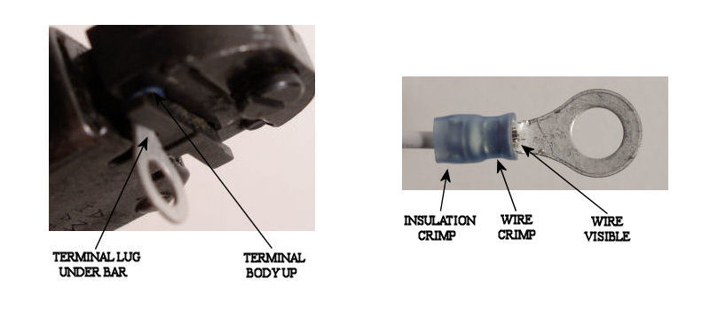

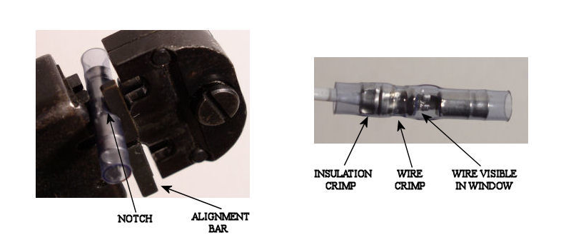

  4. Crimping tools will have an alignment bar for placement. Splices will have a notch that fits under this bar. Terminal lugs also go under this bar. If the terminal is positioned correctly, the bar acts as a "stop" for the wire as it is inserted.
  5. A good splice is characterized by the two crimps at the correct locations and wire visible through the inspection window at the midpoint of the splice.
  6. A good terminal connection will have two properly placed crimps along with the wire visible on the lug side of the terminal.
