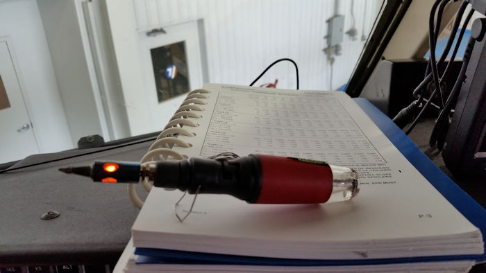

Two tools that are an absolute must for any remote soldering job would be portable versions of a soldering iron and heat gun. I have tried many different types in the past, but as of late, I just use these.
For ease of use, this iron works quite well. It was sold at Radio Shack©, but most if not all those stores have closed. I did find them here on Amazon. Before use, I always find a “safe” resting place for it when it is not in use. There is quite a bit of heat emitted from the forward element and it will burn anything in close proximity. Placement when actually soldering can be tricky. You can easily BBQ a finger depending on your “angle-of-attack” towards the item being soldered.
