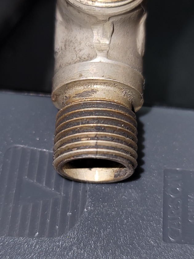

This was actually a "T" fitting feeding pitot pressure to one of the Air Data Computers. The crews were complaining of a 3 knot split at altitude.

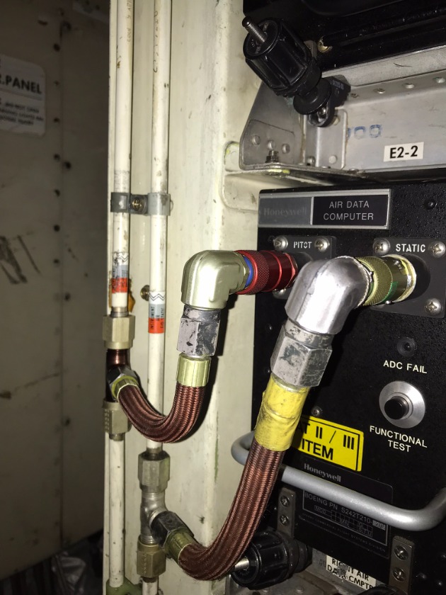

To find these leaks we disconnect the line from the Air Data (which seals the system), and we pressurize the line with the Air Data Test Set. Then comes the fun job of spraying leak detector on all the lines until we find bubbles.
This latest leak was easy to find as it was the first fitting from the computer. Most of the time they're not that easy.
