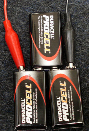

Easy 28 was created by Mark
It might look cheap, but if a quick supply of 28 VDC is needed, it works great. This is mainly used as a "off aircraft" tester for relays, solenoids, and bulbs. Power is limited, using it on larger items is not recommended.
Having a bench 28 VDC power supply available for testing is still the preferred method.
See it in action.

6 years 7 months ago - 6 years 7 months ago #632 by Mark
Replied by Mark on topic Easy 28
Tried to use it on a A/C contactor coil. It didn't work. You could here a click.... but it didn't close.
