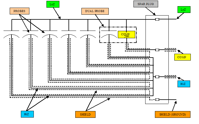

  • Most aircraft fuel tanks have numerous fuel quantity probes installed. The number of probes used can vary depending on tank size and system design. Most common configurations have 6-12 probes. These probes are arranged in a parallel circuit.
  • Each probe is a capacitor. The capacitance value of the probe will change with fuel level changes. The higher the fuel, the higher the capacitance.
  • The input signal that feeds all the probes is called LoZ. The output of the probes is referred to as HiZ.
  • Fuel capacitance is read in picofarads or pf.
  • Capacitance in a parallel circuit is additive.
  • Tanks have one probe that measures fuel density. This is the Compensator Probe. The “comp” probe has a unique function, but its output is still read in pf.

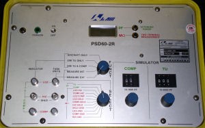

Fuel quantity test boxes are made by numerous manufactures. All will have similar switches and functions. The tester shown here is JcAir® “PSD60-2R.

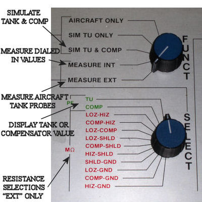

  1. Tank capacitance checks are run with the mode selection in MEASURE EXT.
  2. Each aircraft type usually has a breakout box with all the matching plugs to connect to either the spar plug or indicator. Breakout box connection configurations will differ for aircraft type, but all will have the same outputs for the fuel quantity tester. The co-ax connections are HiZ, LoZ, and Comp (numerous breakouts have only HiZ and LoZ, the Comp is included with the rotary switch selections).
  3. If the test setup is connected at the indicator, only total tank and compensator readings can be made.
  4. If the breakout box is connected at the spar plug, each individual probe can be measured along with total tank readings.

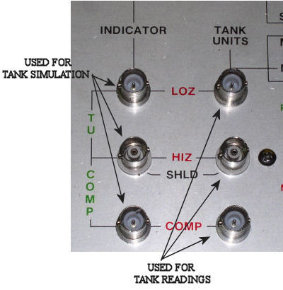

  6. The fuel quantity unit’s TANK UNIT co-ax (BNC) connections are differentiated by gender. LoZ and Comp are male pins. This reduces the chances of incorrect setup (if the LoZ and Comp are swapped, you’ll know it).

  10. A major function of the fuel quantity unit is measuring insulation resistance or a “Meg Check”. Different combinations of shorts can be detected. Minimum values for meg check readings will also be found in the M.M.

  3. All simulations use the INDICATOR co-ax plugs. LoZ, HiZ, and Comp require correct connections.
  4. Simulation values are set with the mode select switch in MEASURE INT.

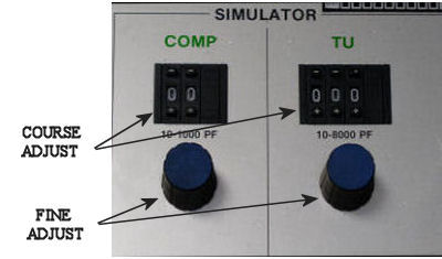

  5. Tank unit and comp values are dialed in with the course and fine settings of the tester. The thumb-wheel indication does not match actual values. The display should be monitored when setting both tank and comp.
  6. After the values have been set, the select switch is placed in SIM TU & COMP. The unit will output the dialed in values and the screen will show dashes or eights.
