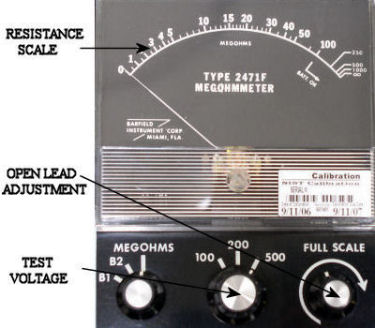

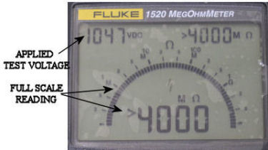

Digital meggers do not require any adjustment to use. Older analog units have an open lead (tests leads not connected) full scale adjustment. Adjust this to maximum or infinity (∞) before use. This adjustment will change with the different test voltages.

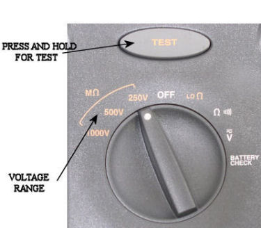

I like to start at the lower voltage settings to check wires. A megger will supply a high voltage potential, but very little current, it is still good practice to start low and then move higher if needed. A good check indicates as close to maximum (∞) as possible.
