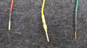

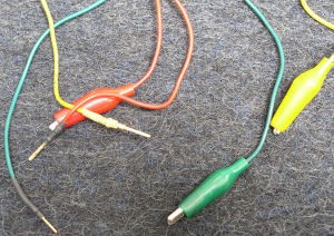

I use test leads that I made from Amazon alligator clip jumper wires . I cut them in half and crimped various size pins on them. I use heat shrink tubing to protect all but the working end of the pin.

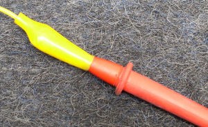

I ground down the tips of my meter test leads about ΒΌ" to accommodate the alligator clips. When I hook up to the meter lead, I push the rubber of the clip over the plastic of the lead. This prevents inadvertent grounding of the alligator clip on metal. It's always nice to see that split second of flash and spark, then be left wondering what you just fried.
I like to have at least two each male and female sizes in the red (20) and blue (16) gauge pins. Digital computers use smaller pins in the 24-26 gauge range. The males in this range are easier to obtain because the rack plugs use them. The females are not easy to find, they are on the computer (LRU) plugs. The component shops have them, but line mechanics do not normally have access to these. The problem is, the females are needed to get into the rack pins for troubleshooting. If you find any females in this smaller size, take care of them.

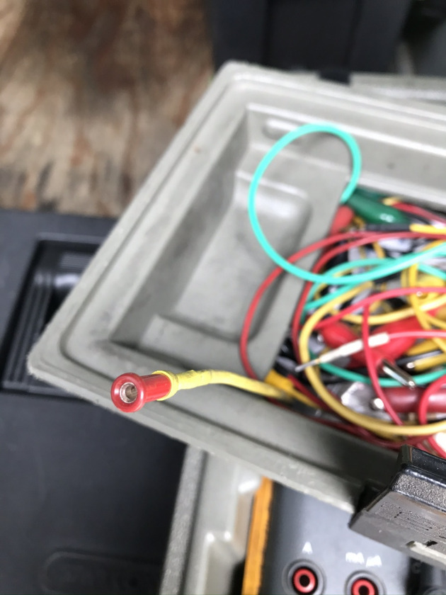

5 years 9 months ago - 5 years 9 months ago #721 by Mark
Replied by Mark on topic Test Leads

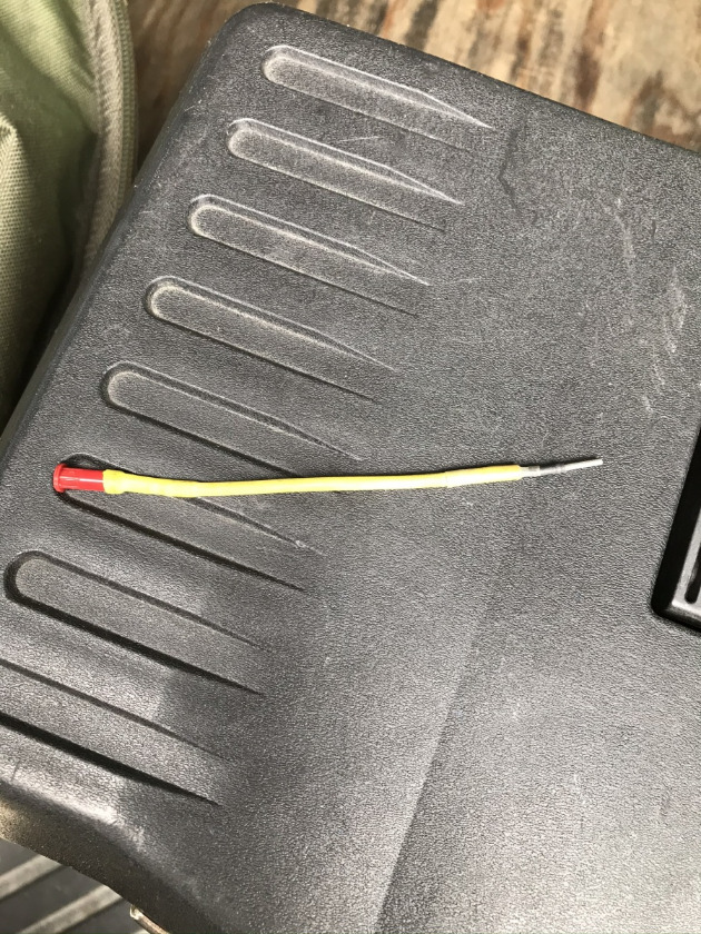

Test leads made with thick safety wire doubled up used with these sockets .
These are great for rack and circuit card connectors where you're not quite able to squeeze your hand in with a regular type of test lead.
Last edit: 5 years 9 months ago by Mark.
5 years 9 months ago #725 by Clipper
Replied by Clipper on topic Test Leads
So the safety wire is making it rigid enough to prevent it from becoming limp as you feed it into the difficult to reach connector?
