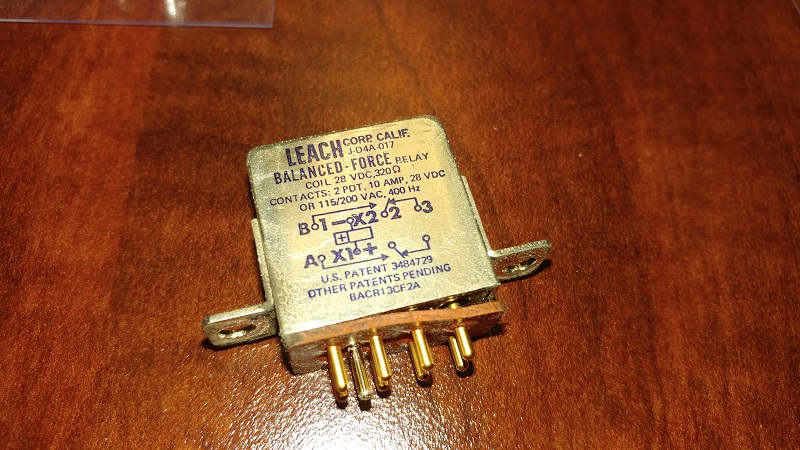

Leach Relay P/N BACR13CF2A
7 years 7 months ago - 7 years 7 months ago #565 by Mark
Leach relays are used extensively on all Boeing, Airbus, Douglas, and Gulfstream aircraft. They can be found in numerous other types of corporate aircraft.
They are extremely reliable as they can last numerous decades with thousands of cycles.
Years ago, I encountered a relay from a Gulfstream that was acting like the car blinkers of old. The coil would get hot and go open which caused the relay to relax. As soon as the coil cooled, it would energize again.
rotate.aero/forum/relays-general/79-leac...and-closes-from-heat
In my short few months on the 767 I have found "two" examples of the same fault.
rotate.aero/forum/ata24-767/314-ata-24-3...ilure-indication#564
rotate.aero/forum/767-ata27/304-ata-27-62-auto-speedbrakes
Both have had the same part number BACR13CF2A.
In defense of Leach, both of the recently failed relays were quite old (as noted by the pitted "feel" of the case).

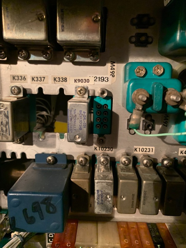

5 years 9 months ago - 5 years 9 months ago #737 by Mark
Replied by Mark on topic Leach Relay P/N BACR13CF2A
Another one......
You can't hear it click over the equipment cooling noise, but the repetition was every few seconds.

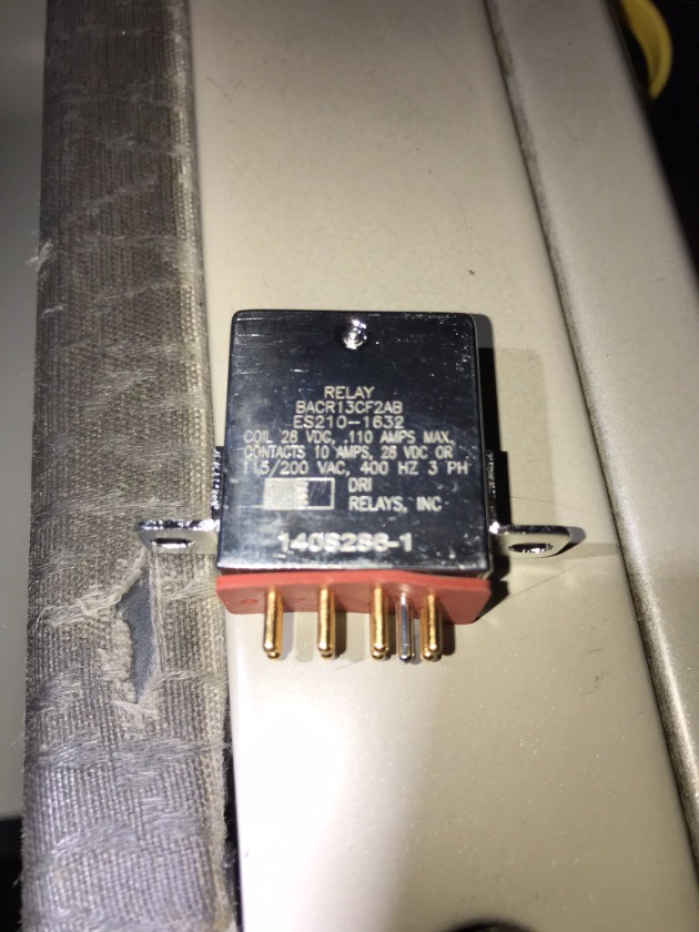

4 years 2 months ago - 4 years 2 months ago #802 by Mark
Another relay acting like a car blinker.
This time for the right wing anti-ice valve disagree warning.
The relay must be energized to keep the warning from view, so it spends most of its life engaged.
Activated relays get HOT, which causes higher failure rates.
A suitable substitute, part number BACR13CF2AB can be used as a replacement.

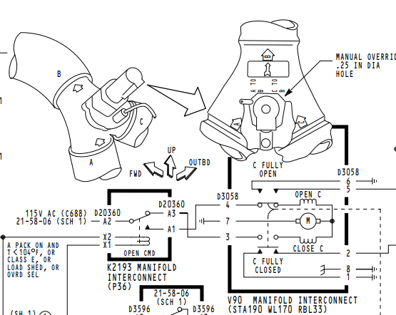

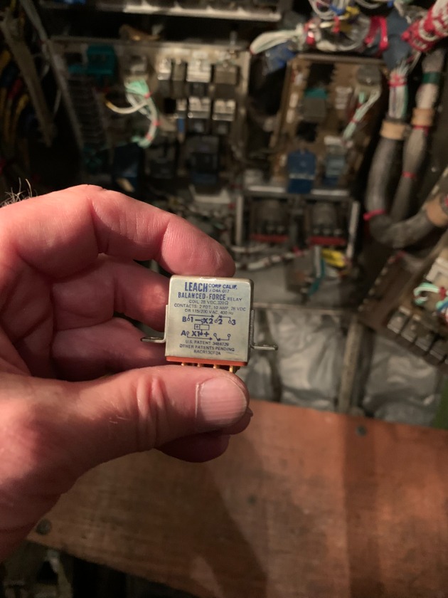

1 year 4 months ago #1724 by Mark
Another one.... (longer duration of 6 minutes this time).

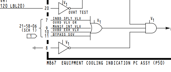

This one controlled the Manifold Interconnect Valve for the forward equipment cooling system.
Approximately every six minutes we get a "Valve" light on the cooling control panel and a "Fwd Eqpt Valve" message on EICAS.
We had to isolate this one with engines running. 30 minutes and a 1000lbs later..... we found it.
Please reference  rotate.aero/forum/767-21cooling/380-ata-21-58-equipment-cooling   for more information on troubleshooting these types of messages.

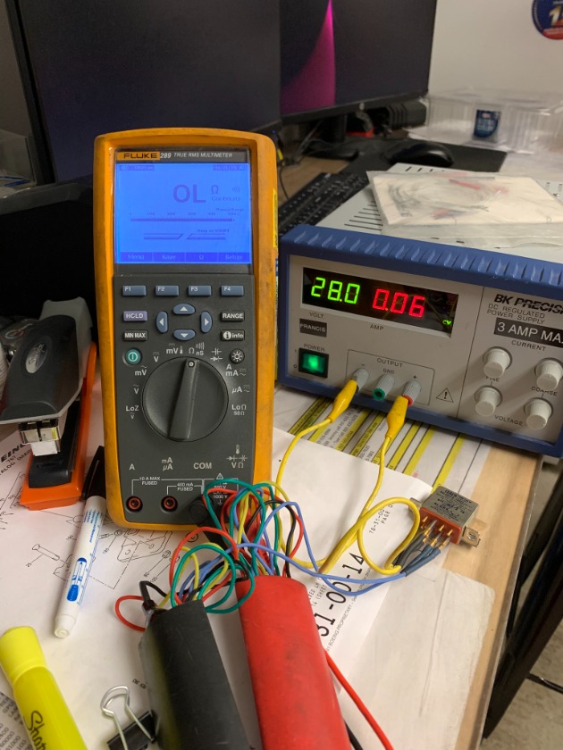

We tested the bad relay on a power supply after removal.
