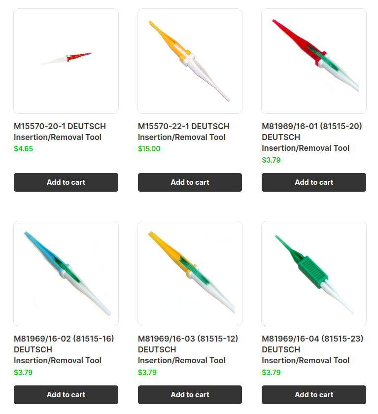

Part Number Reference For Pins/Terminals/Tools/etc
3 years 6 hours ago - 2 years 11 months ago #1236 by Mark

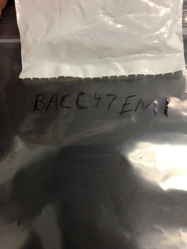

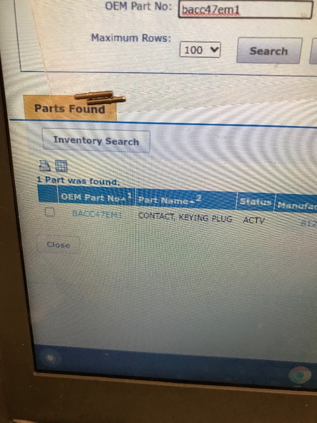

Alignment pin - BACC47EM1
Please reference here for card replacement forum entry.

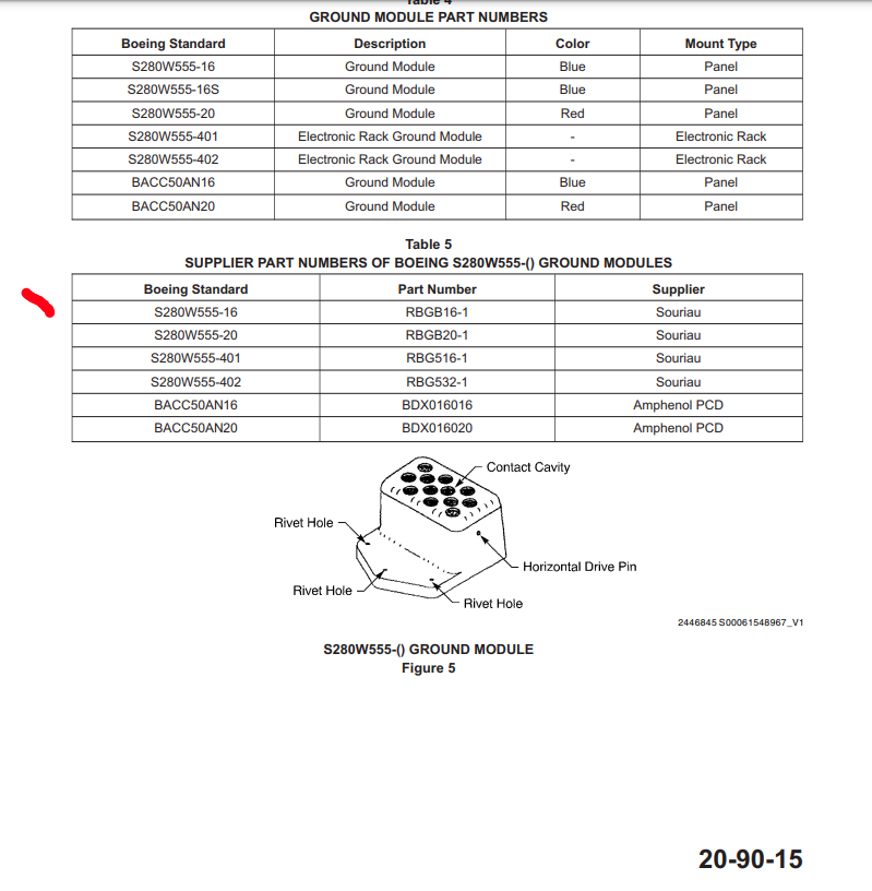

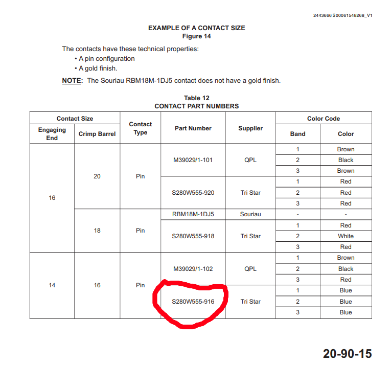

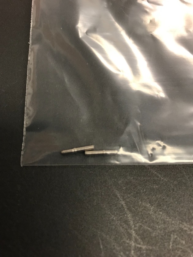

I found a riveted on ground block which I've never dealt with before.
Some info on part numbers and pins.....
1 year 2 months ago #1746 by Mark

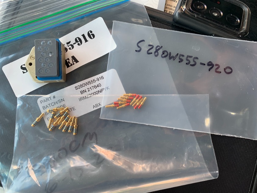

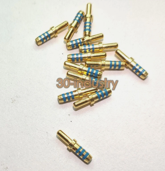

For the post above on the riveted terminal block......
The red pins are "not" used for the block part number listed above.
They are a smaller diameter.
The blue pins are correct.

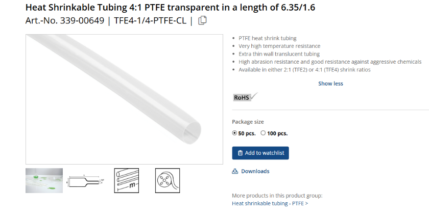

 Fire Loop Heat Shrink
