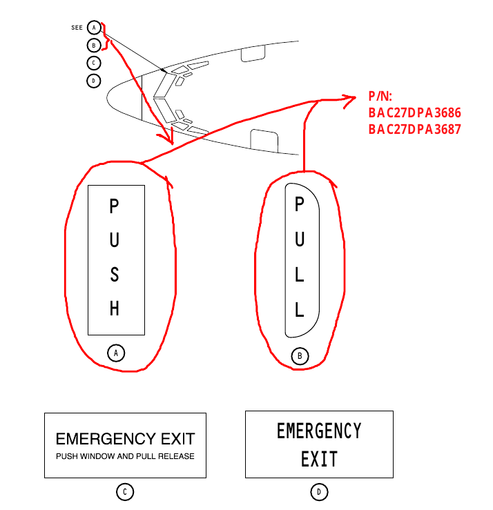

With regard to push/pull placard detail I have just emailed, would you mind explaining how they are installed on fuselage and do you have any idea on material the placards may be made of?
3 years 2 months ago #1143 by Mark
Replied by Mark on topic Placard

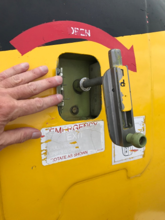

These are the instruction placards for opening the DV (Direct Vision) or sliding windows from the "outside" of the aircraft. Emergency personal can open the windows in case of incapacitated crew members in the cockpit.
3 years 2 months ago #1144 by dynamics
Replied by dynamics on topic Placard
How they are installed on fuselage?
3 years 2 months ago #1145 by Mark
They're sticky on the back. This should all be explained in the maintenance manual.
3 years 2 months ago - 3 years 2 months ago #1146 by dynamics
There are two instructios: 20-10-11 for pressure sensitive decals and 20-10-14 for pressure sensitive placards which I have just sent, which one is applicable?
Last edit: 3 years 2 months ago by dynamics.
3 years 2 months ago #1147 by Mark
-11 clearly states external. (Decals)
-14 internal. (Placards)
The items mentioned above are external.
3 years 2 months ago #1148 by dynamics
Why they are called pressure sensitive? What is the difference of placard and Decal?
3 years 2 months ago #1149 by Mark
Pressure sensitive..... push on it..... it sticks.
As the AMM stated, placard inside the aircraft, decal outside.
