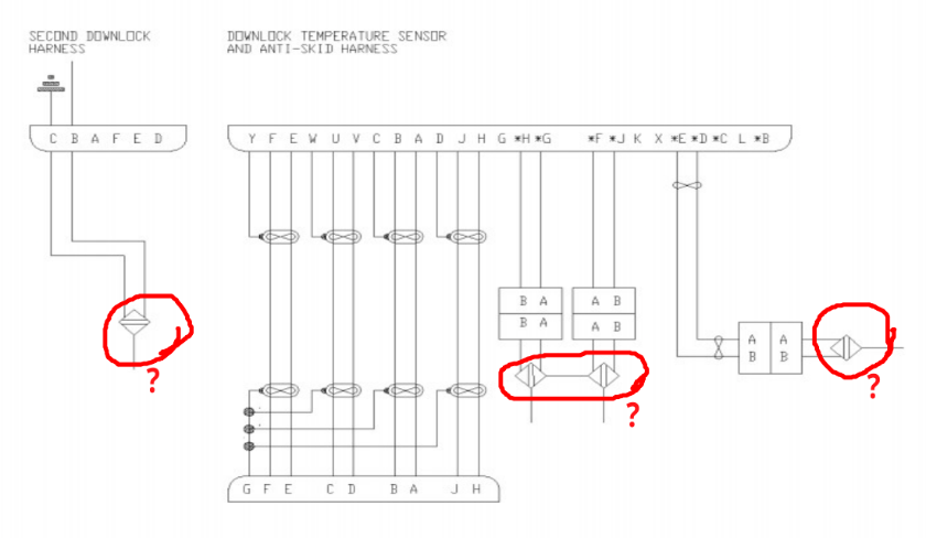

Mark, with regard to a page of WDM corresponding to main landing gear harness I have just emailed, do you have any idea about red encircled wiring symbols?

I have never seen that symbol before.
Do you know where the wires go after leaving the feed-through plugs at the top of image??

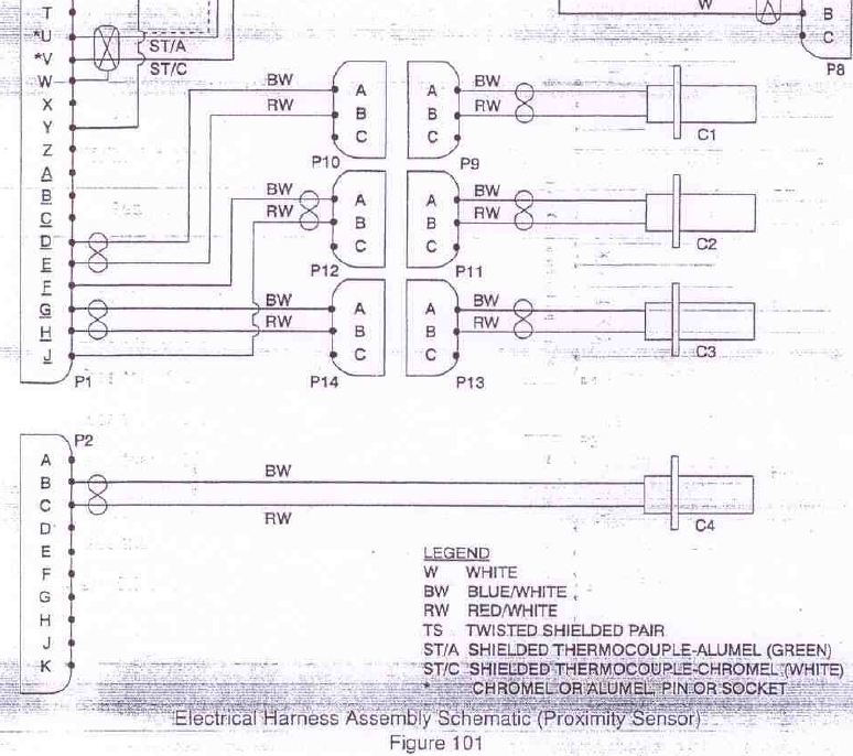

I have just sent the component doc, please go to page 41

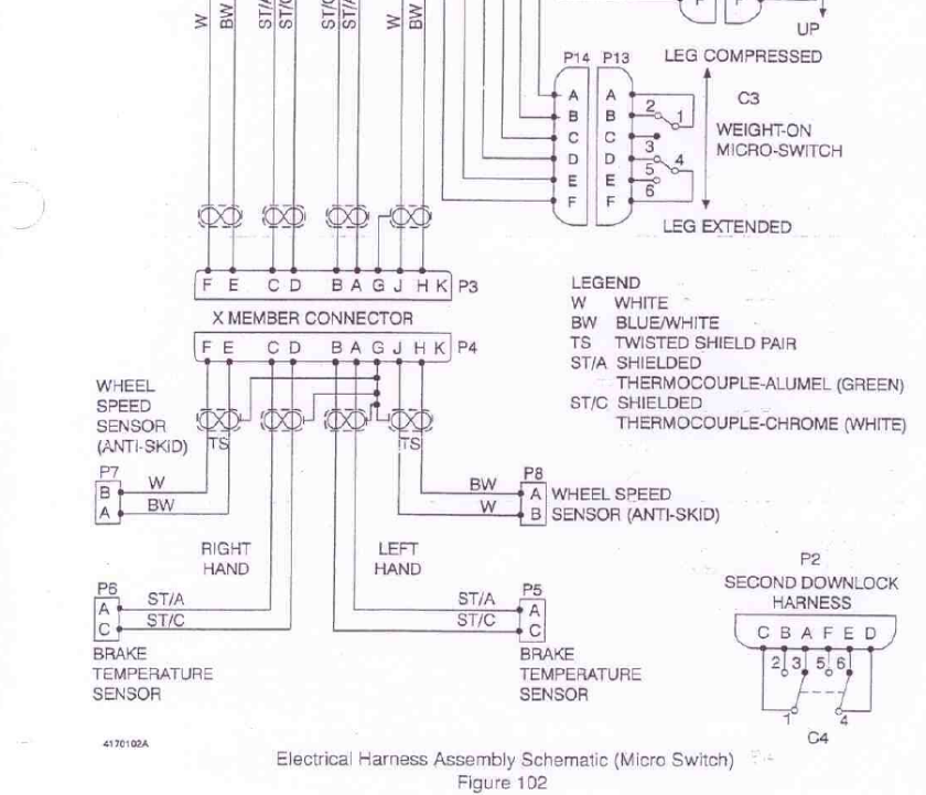

From checking your last email, it looks like those items are proximity sensors.
They're labeled as "C" items, but other than the title at bottom of page, there is no cross reference as to what they could be. The pin-outs match your previous print.
The wheel speed transducers and brake temp sensors go to different pins on the harness.

Proximity and micro-switches show position. Speed sensors do exactly as the name says..... output a rotational speed.
On a gear assembly there are wheel speed sensors for Auto-Bakes/Anti-Skid, brake temp sensors, gear tilt sensors (if four or more tires per gear), brake fans (if equipped), squat switches (for weight on wheels), and gear position switches (either micro or proximity).
Not all gear have every item listed above, but you can understand the amount of wiring to support all these.
You're comparing apples to oranges as far as functions go. Each item has its own use. Each item has its own wires.
