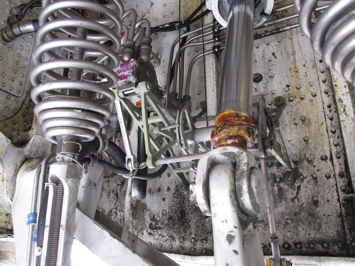

For people not familiar with how McDonnell Douglas built aircraft…… air-ground switching is accomplished by using a cable attached to the upper scissor rod. Depending on strut extension, (short with weight on – long with weight off), this cable actuates two fairly large switches in the forward electronics compartment. These switches control a shit-load of air-ground relays that feed all the separate systems needing air-ground information. This system has been used on all MD products from the DC-8 on through to the MD-11.
(In this view we're looking towards the top of the strut. The upper link rod is located on the left. The cable is visible on the right wrapped around the bell crank.)

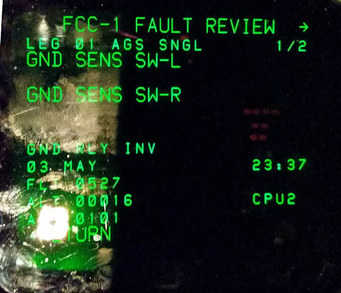

After some digging for information, the CFDS was accessed to look at flight fault history. Both FCC’s showed this.
Of all the air-ground relays, R2-5209 (Left Ground Sensing) and R2-5112 (Right Ground Sensing) feed the FCC’s. Each FCC gets input from “both” relays. Obviously, one of those relays was wrong.
What was puzzling was the fact that all the air-ground relays are controlled mechanically via the strut, cable, and switches mechanism. If we had something stuck, wouldn’t cycling the upper scissors arm correct the problem? Why did only the power dump correct the problem? I don’t have an answer, but I “will” be watching the aircraft for a while.

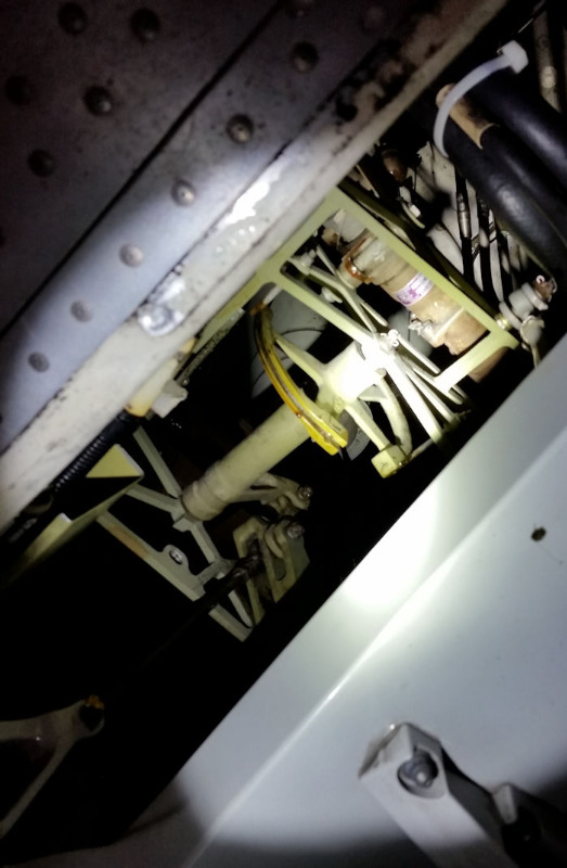

A couple more pictures.
Air-Ground cable(s) going vertical off of bell crank seen at left. (Actually two cables are used.) Rod from top scissor visible on right.
Air-Ground switches in the forward left of the E&E compartment. The rocker arms can be seen at top of picture. These arms are actuated by a cam driven by the cable.
