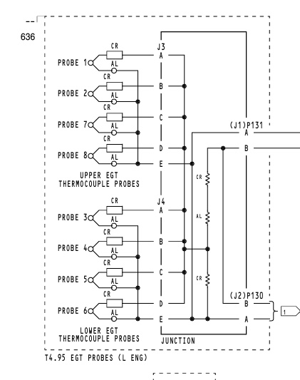

For the life of me, I cannot remember how the EGT thermocouple gang does it’s job. There are 4 probes in parallel all connected to one output on a CF6-80C2. If one probe is removed from the equation, does the temperature indicated go up or down?

Thermocouples create a millivolt output in relationship to heat. If you loose a probe or section..... the output will be "less". Your temperature indication will be "lower" than what it should be.
