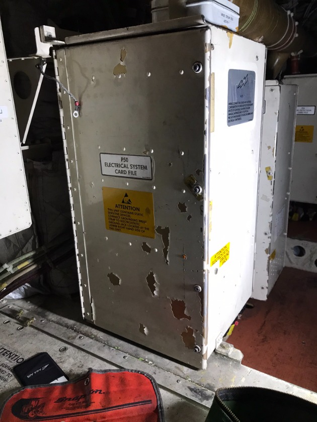

Maintenance Control request to change one of the card connectors in the P50 panel.
Removed.....

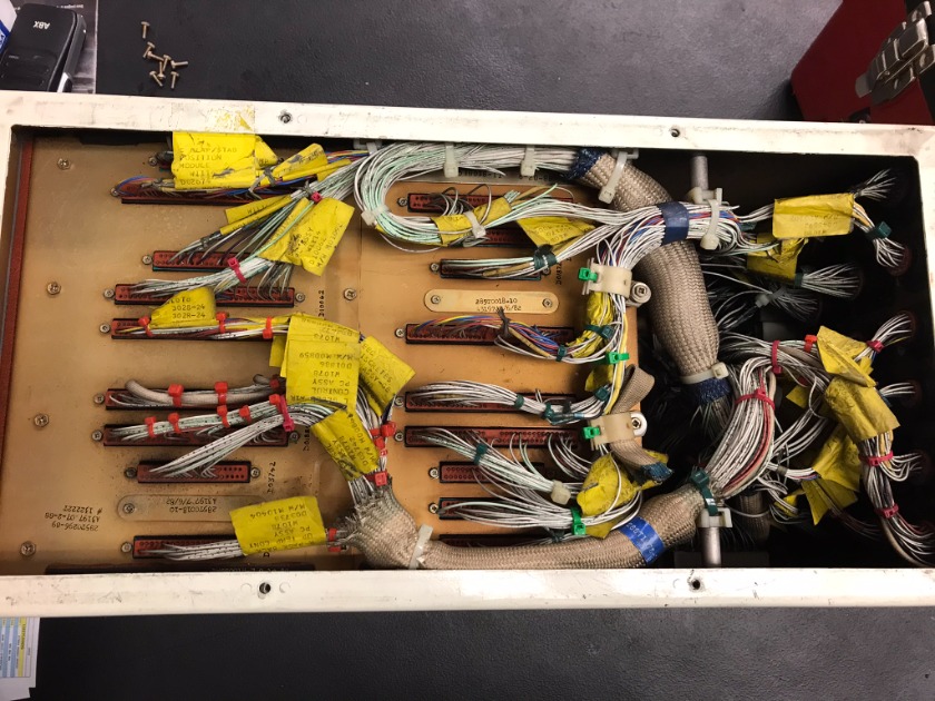

Back cover off.....

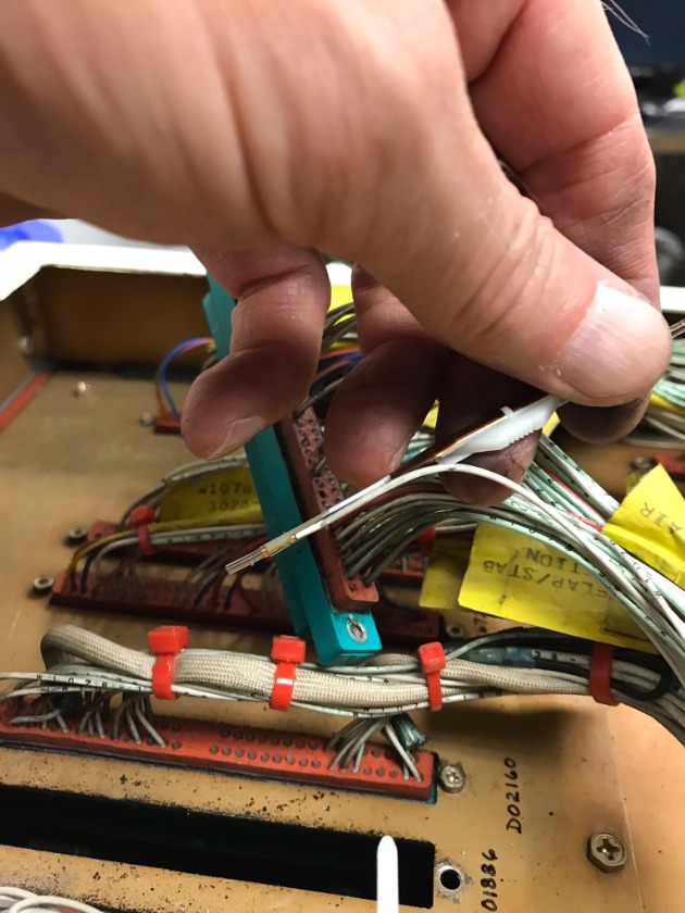

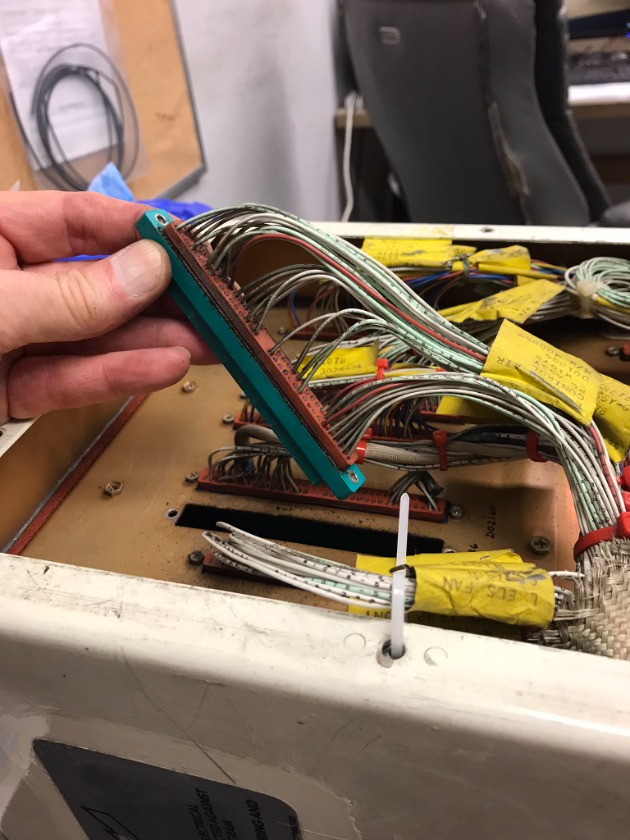

Fortunately, the connector slides out the back side.

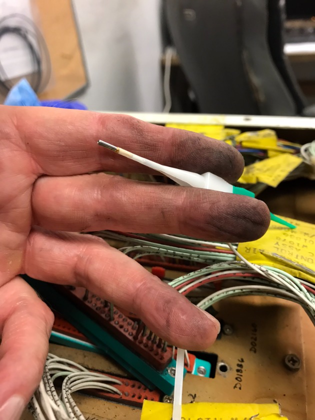

The $120+ dollar tool called out in the Standard Wiring Practices Manual.....
vs. the standard green/white plastic....
(I won't be spending any money on the expensive tool.)
