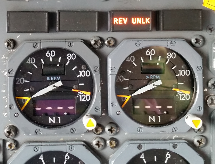

A300-600, Right-Hand T/R inop. Both sides deploy, but only the left stows.
The indication for deploy is correct with the green reverse light on. With the T/R throttle handle down...... you're left with

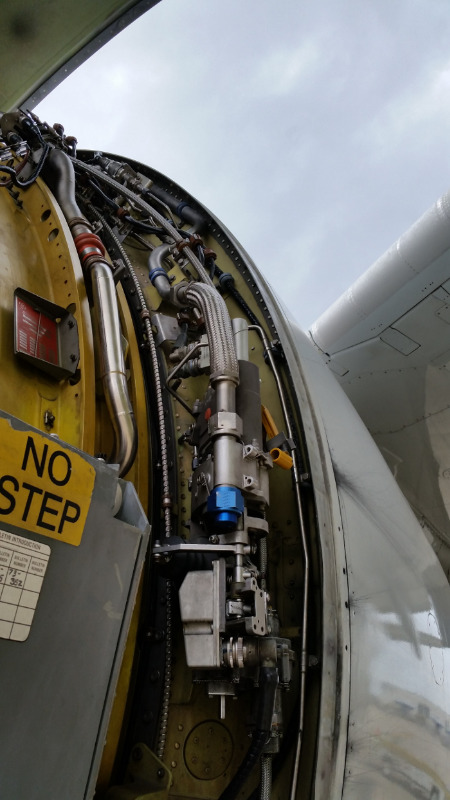

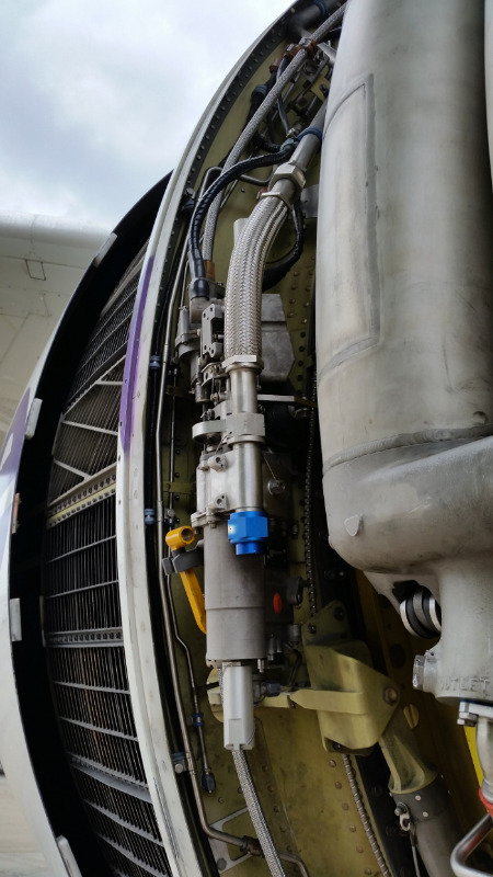

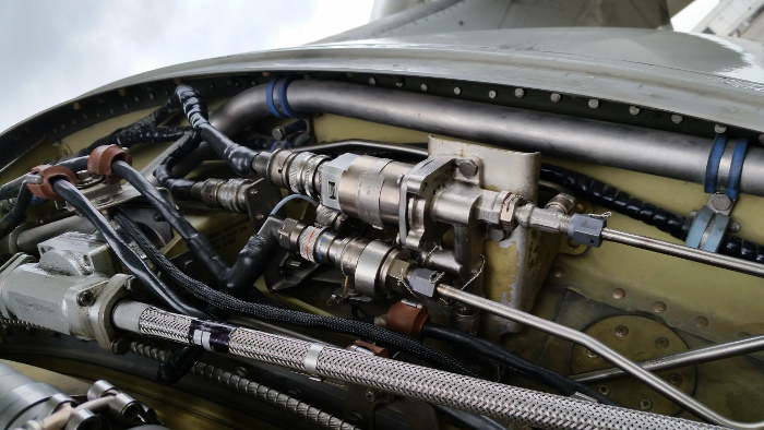

Both halves are controlled by the "same" air supply. This air comes from the Directional Pilot Valve.
There is a "T fitting" just to the right of the valve in this image. This control air goes to both L/H and R/H CDU's.

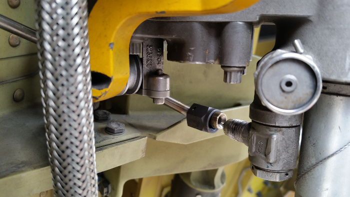

One simple check is to disconnect the DPV control air input "B Nut" on the CDU. It is located on the bottom of the R/H CDU and on the top for the left.
The air pressure needed for the internal CDU directional control valve is about 5 PSI. With the throttle handle in the reverse position, air pressure is present at the line. With the throttle handle down, no air.
You can put your finger right on the end and feel the pressure. You can actually control the opposite sleeve (T/R handle up) by either blocking or releasing that control air. Plug it, the sleeve opens. Pull your thumb off (pressure releases on both sides) the sleeve closes.

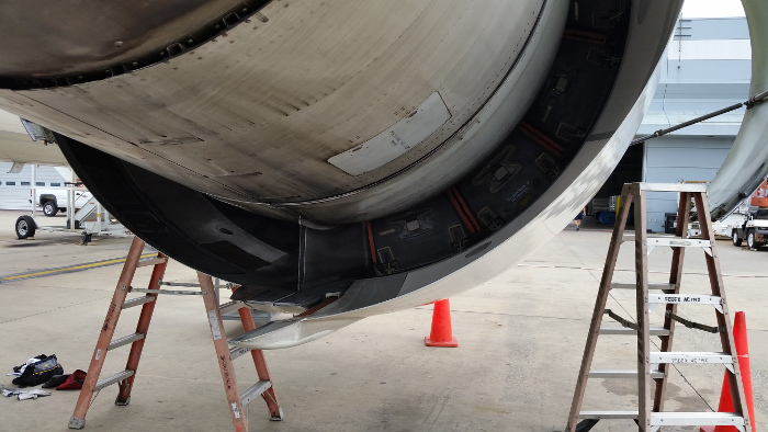

In our case with this aircraft, the control air was correct. When we went to manually close the sleeve a "pop" was heard at the beginning of forward travel (something jammed). When air was reapplied, the sleeve closed. A rig will need to be completed. If that doesn't do it..... a CDU change.
ONE WARNING..... NEVER PLACE YOUR HAND AT THE SLEEVE CLOSE POINT AT ANY TIME, AIR ON OR OFF. IF YOU'RE TROUBLESHOOTING AND THE SLEEVE CLOSES ON YOUR HAND, YOUR HAND WILL LOSE "EVERY TIME"!!!!
