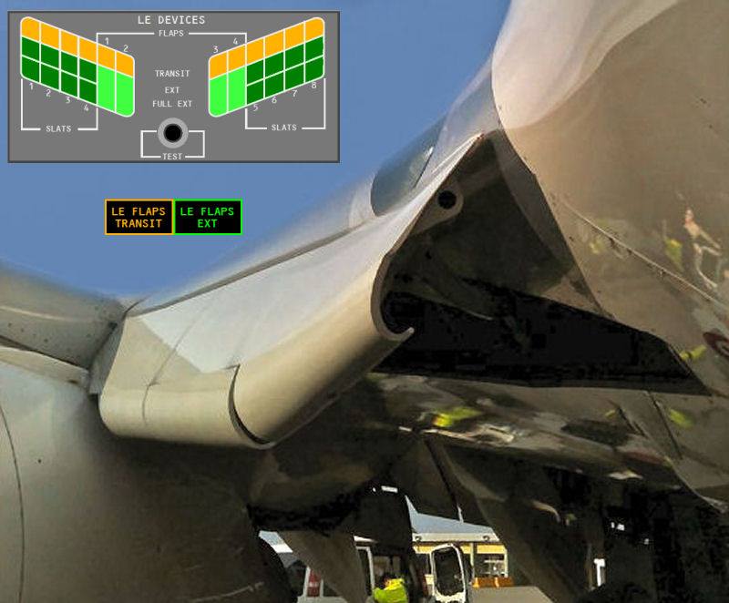

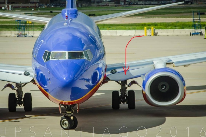

The bussing plugs are mounted to the forward wing spar under the Krueger Flaps.
Those flaps can close quickly and take a person's head off.
Any time someone is working behind the flaps, hydraulics should be locked out. Safety lockouts (if you have them) should also be used.

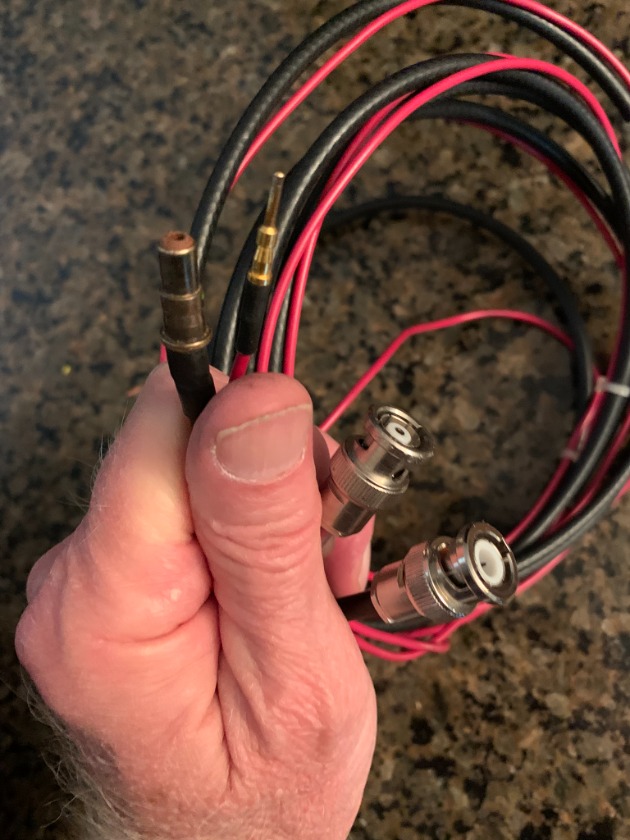

11 months 1 day ago #1807 by Mark
Replied by Mark on topic Fuel Quantity Indicator
This is the adapter to check individual probes at the removed bussing unit at the wing spar.
