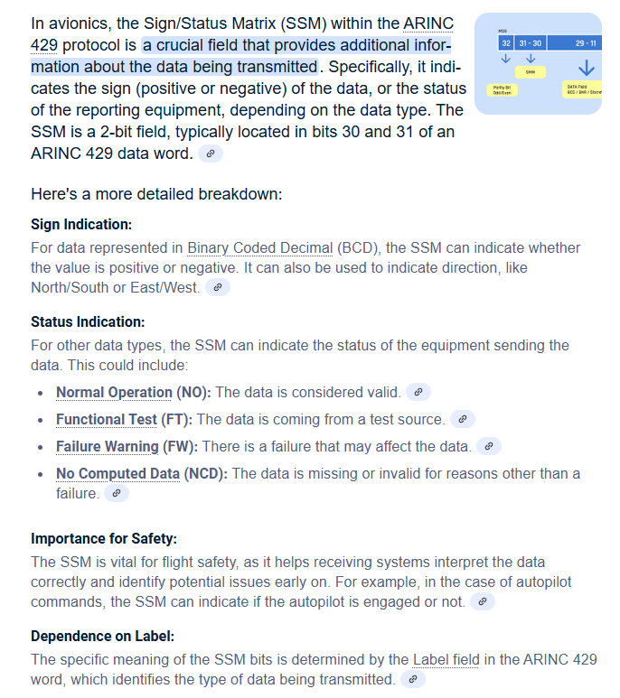

What you sent doesn't seem to fit in with your previous issue on the SGU.
It's talking about the Flight Mode Annunciators, but I understand where you're trying to go with this as a comparison to your original problem.
Your reference is talking about SSM in relation to a 429 bus. It is saying the identifier for parity is wrong..... just like your SGU fault.

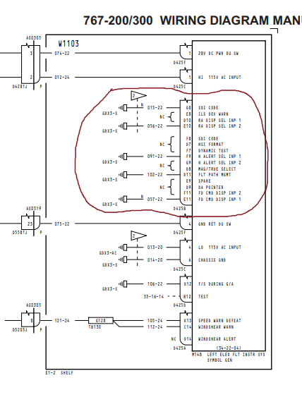

10 months 3 weeks ago #1766 by Mark
Replied by Mark on topic Parity error-2
This is a typical 767 SGU. The pins circled are parity pins. These go to ground, but it doesn't matter if they're hooked to each other also.
You need to find the pins on the prints for your aircraft and find out if one is not connected.....

10 months 3 weeks ago #1773 by Mark
Any ground pin not associated with power or case ground.
It's never just "one" pin. It's several and their total number (odd or even) is the parity.

10 months 3 weeks ago #1776 by Mark
Has anybody gone out a checked the pins on the aircraft?????
Looking at manuals isn't going to fix the problem.
Get a meter and your wiring prints and check the parity pins. One is broken. Find it. Fix it.
