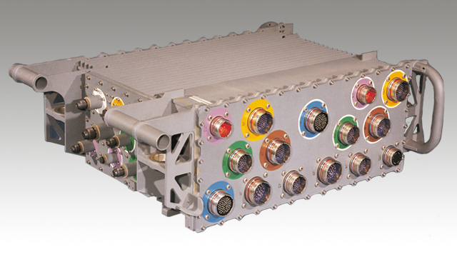

Two examples are the engine FADEC units and the newer Standby (Attitude, Heading, Altimeter, Airspeed) Indicators in the cockpit.
Engine specific strapping (or coding) is on one plug that attaches to the FADEC. It is chained to the engine.
Aircraft specific data is coded to a plug that connects to the Standby Indicator. A chain connects it to the aircraft wiring harness and not the instrument.
Here's a picture of a FADEC unit. I'll have to take a pic of one (with the programming plug) on an actual engine.

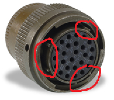

Plugs use alignment keys to keep it in the correct position before tightening down. There is no chain.
The alignment keys make sure that the wrong plug is not installed on a specific receptacle..
The keys are different on each plug if a large number of plugs are in one area.
The only chains I've seen are used on the programming plug mentioned above.
