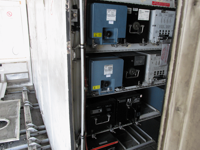

As a precursor, both the #1 FWC and the SDAC were seeing the fault. The FWC receives all three grounds for its circuitry, but the SDAC only looks at one. If both computers were seeing a problem, it was most likely on the one wire that fed them both.
Two FWC's, blue on top - SDAC, single black box below.
