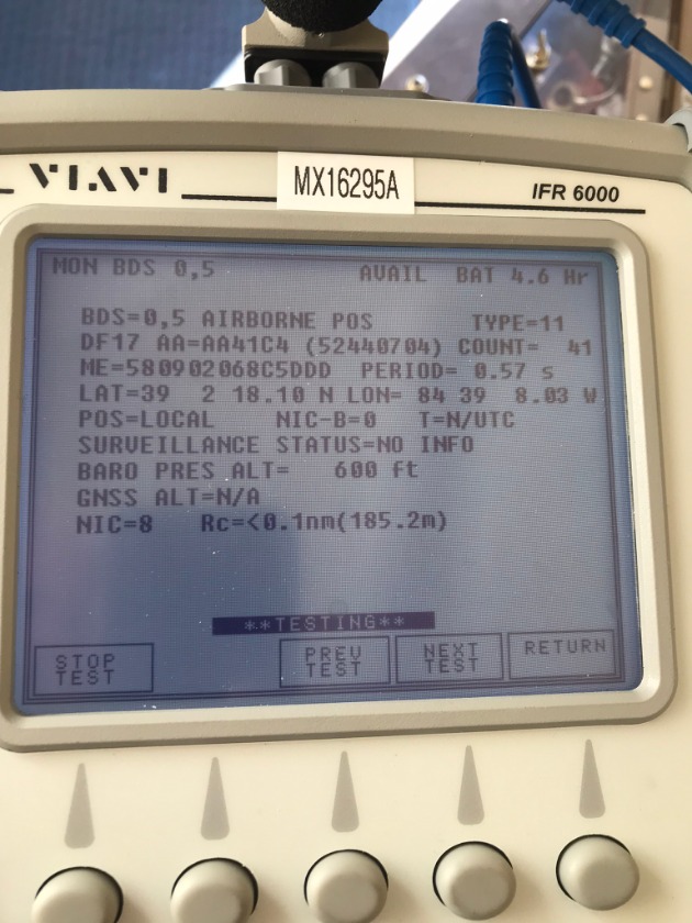

On the IFR6000 there is a second (more in-depth) Mode "S" test page (which I didn't check the first time) that shows current Lat/Long position. That position was not there when checked.

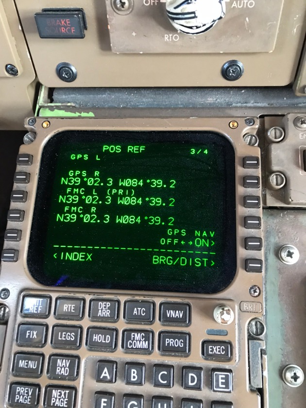

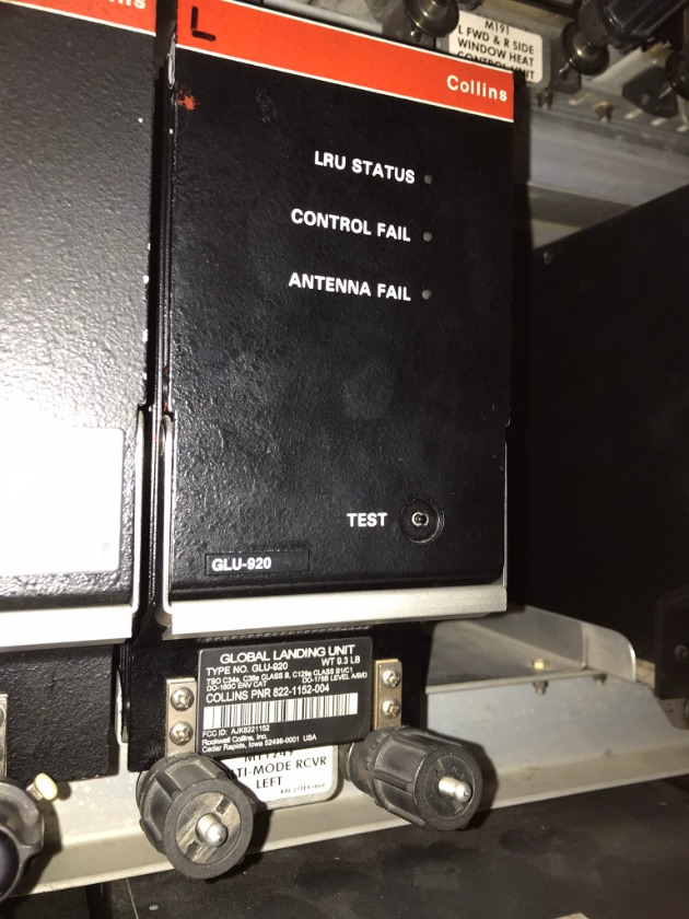

When the right MMR was pulled, the right ATC lost its position. A MMR or Multi-Mode Receiver has an ILS receiver and a GPS receiver in one unit.
The MMR sends position information to several users. One being the FMS..... and guess what..... no GPS data there either.

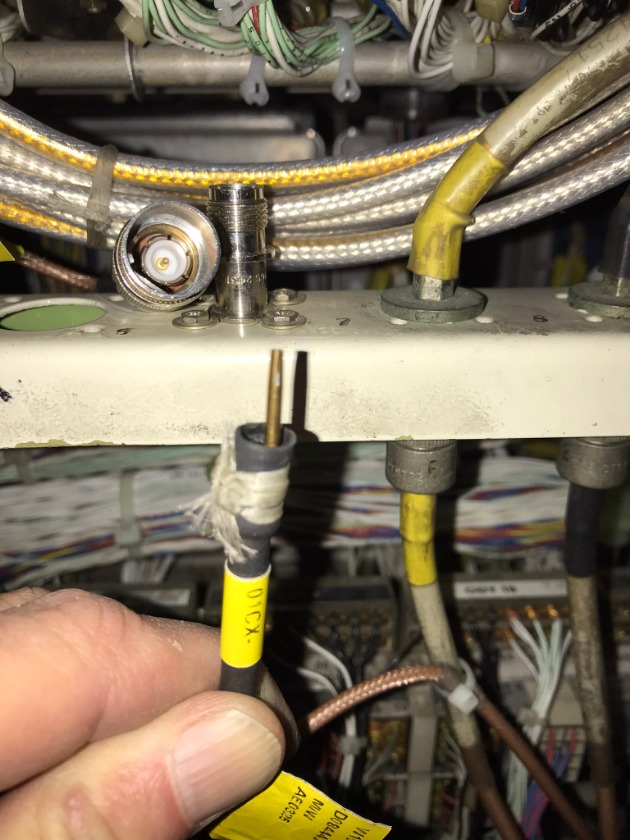

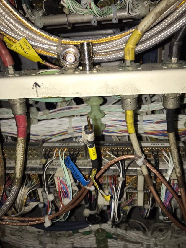

OK..... whats the issue? Swap - no help. Check the antenna with ohm meter..... open.
I wonder why it's open????? Could it be the rack disconnect plug has a wire hanging from it? Yes.
We replaced the jack plug. All user systems operated correctly after the repair.
