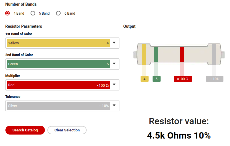

If a bad loop has been isolated, throwing a decade box across the terminals should at least give you a valid test from the cockpit.
Or..... just throw a 4.5K Ohm resistor across them.
