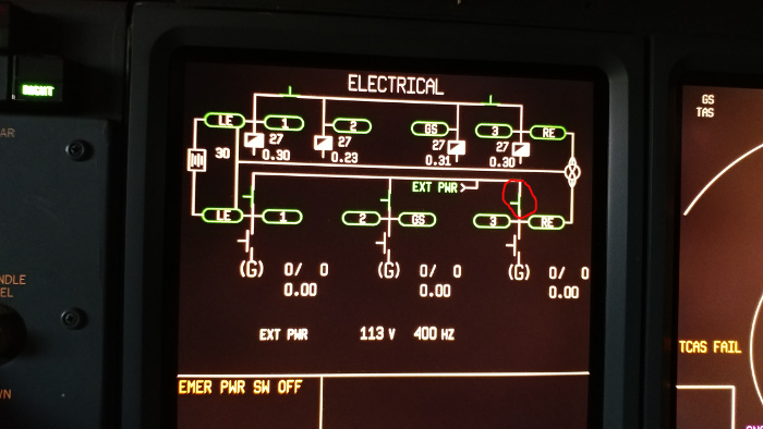

8 years 10 months ago #419 by Mark
Replied by Mark on topic A/C Bus Tie Disconnect
Bus Tie #3 highlighted.
