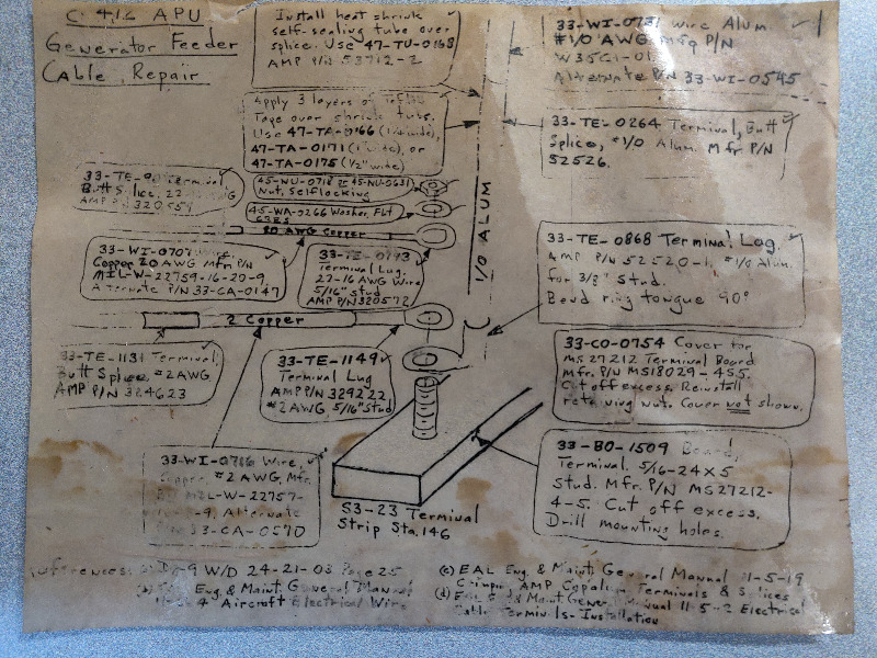

Found during engine change, shorted IDG power feeder wire. Approximately 20 inches away from IDG connection terminal. How this thing didn't cause a differential fault is beyond me.
A 1/0 cable splice and terminal were needed for repair. Some part number references.

6 years 7 months ago #640 by jake ounce
In our SPWM it states all engine wiring with damage must be replaced in it's entirety. I noticed you had 14 FT of cable. I watched the repair of an IDG cable using that hydraulic machine- pretty impressive.
