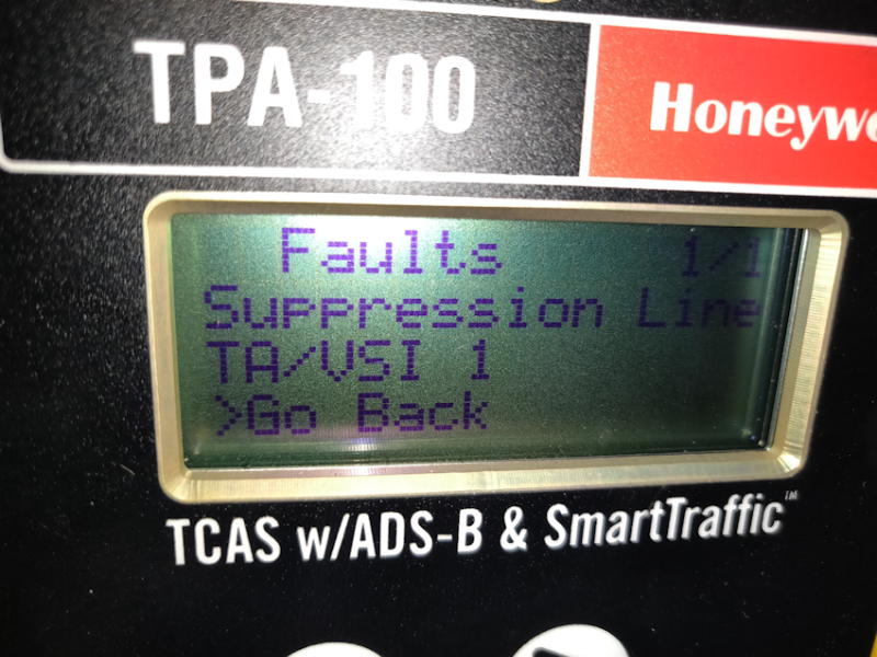

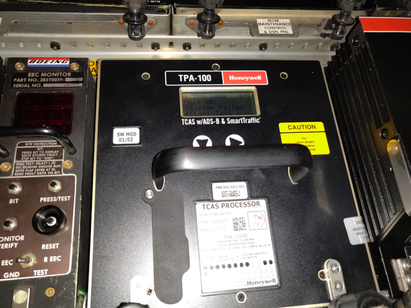

Honeywell TPA-100 TCAS Processor with "Suppression Line" fault. The TCAS system test failed.

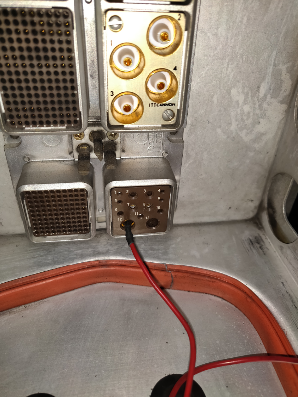

On this particular aircraft, the TCAS suppression line did not have continuity to the other units.

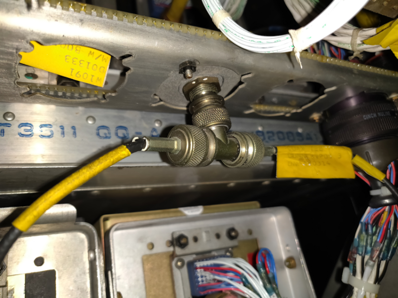

There were two co-ax "T" fittings and a single co-ax junction used to connect the units.

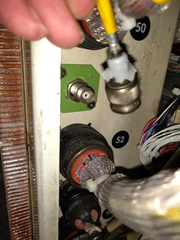

After the aft E&E wall was pulled down........ the TCAS suppression co-ax was plugged into a "unused" bulkhead connector. After the connector was placed on the "correct" junction..... the TCAS system tested correctly. ( The aircraft had recently completed an ADSB modification.)
