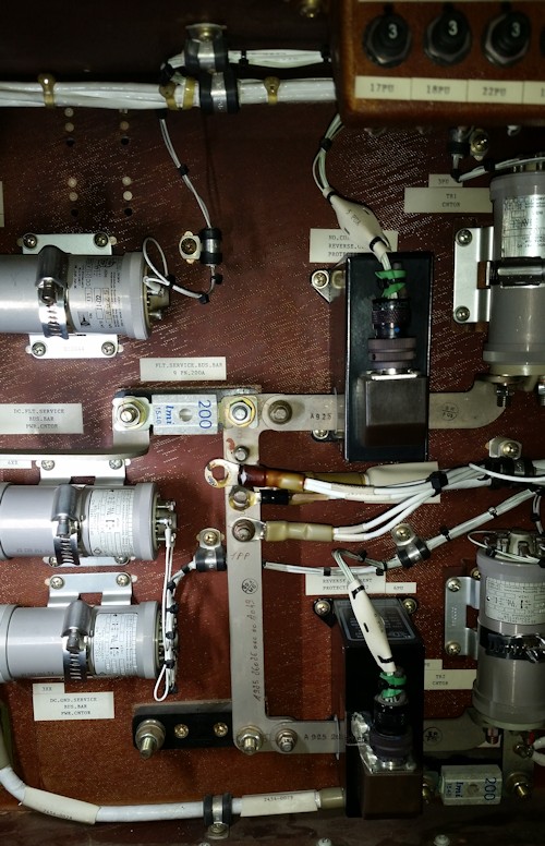

I was dead set on a high amperage draw downstream and I began pulling the cockpit jump-seat to gain access to (my favorite three words in aviation) a downstream terminal block so that I could further isolate the high amp draw.

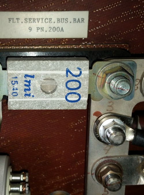

My lead suggested checking upstream before I gutted the cockpit. I'm glad he did.... this is what we found.

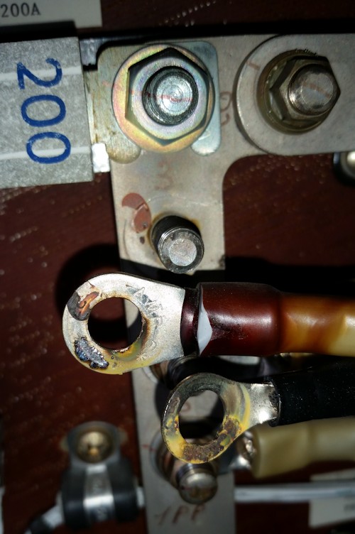

A mounting nut was loose. There was enough of a connection to give us 28 unloaded, but as soon as even the lightest load applied, it dropped to 12.The wires showed signs of heat damage and the nut itself was falling apart.
The wires themselves were OK and the terminals needed a wire brush cleaning.
We installed a replacement nut, but it was not the exact type called out in the IPC. An EA was issued for flight and the nut was replaced the next day.
