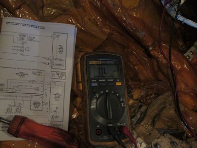

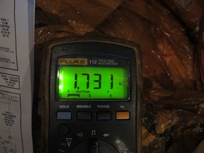

#3 pack on a MD-10. When turned on, immediately drives to full hot and over-temps.

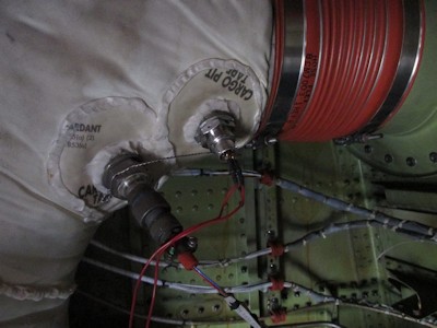

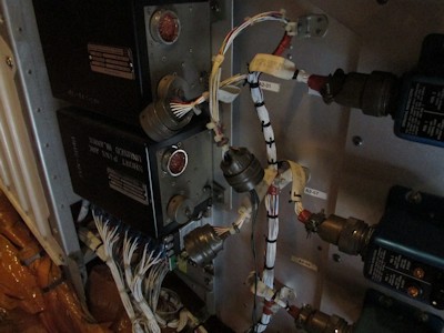

Compared pins "e" and "f" (both little) at pack temp controllers. These connect to the outlet temp sensor. Found #3 open while #1 & #2 read approx 1.7k ohms. Shot the sensor directly to eliminate wiring.... it was open.
