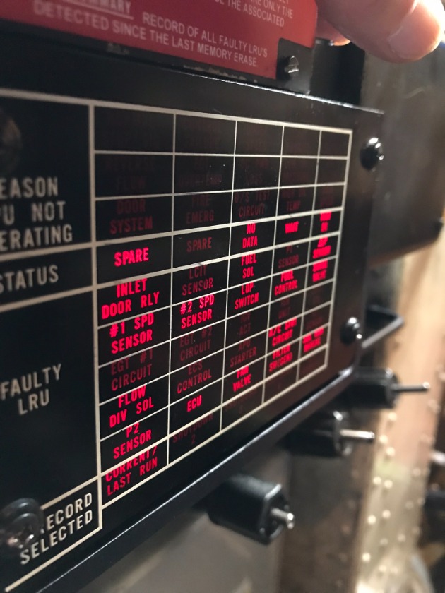

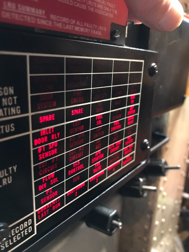

The APU ECU (Electronic Control Unit) mini-flag test is another tool for troubleshooting APU start or run functions.
To see the mini-flags..... press and hold "Lamp Test". After all rows have been sequenced, the code can be read sideways.
28
91
OK
