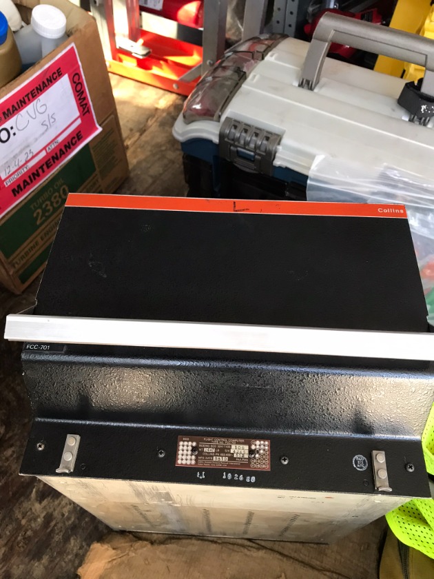

Weird one. MCDP test 66 (sensor position) showed the Left A/P Rudder Servo at 20+ degrees with hydro on. Hydro off..... it fell back to 0.
Swapped left and center FCC's. Normal left, normal right??? Swapped back, messed up again.

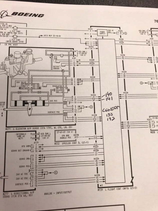

Shot the servo coils..... 140'ish for left. 130's for center. (The circled "A" on the print represents 26VAC sensor excitation).
Replaced FCC..... All good!!

1 year 10 months ago #1542 by Mark
Replied by Mark on topic Rudder Servo Position
Sure as shit.... after looking at image of print above, I shot the elevator servo.
This story has more to go as to "if" the FCC actually fixed the problem.
