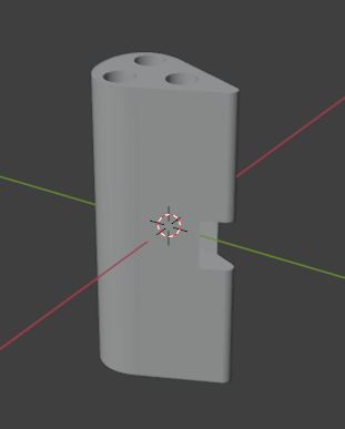

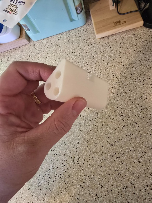

Was getting sick of digging through the bag of pins in the door for the gear pins, so I created a 3d print model of a gear pin holder to make them easier to find. Made like the ones that come on the 650 not sure if this originally came with the aircraft and was lost or they never had one. Either way this fits the pins quite well, will have to see how it holds after time may need to change material after all the hot and cold cycles.
Printed : PLA
Print Time : 1:45
Print Cost : .25
File Download
File Attachment:
File Name: G450GearPins.zip

File Attachment:
File Name: G450GearPinsredo.zip
File Size:475.33 KB

10 months 1 week ago - 10 months 1 week ago #1838 by OG GarlicSalt
Replied by OG GarlicSalt on topic G450 Gear Pin Holder
It should be 85MM the size is roughly 25.84x40.00x85. I made it all in mm.
Last edit: 10 months 1 week ago by OG GarlicSalt.
10 months 1 week ago #1839 by OG GarlicSalt
I think I see your issue, when I open the file in blender and Creality the model is sharp, I opened it in meshmixer and I see the odd lines and fragmented faces. I think it just comes down to the boolean operations destroying the faces. Let me know if your not able to get it to turn out I will re create it in Autodesk tomorrow.
