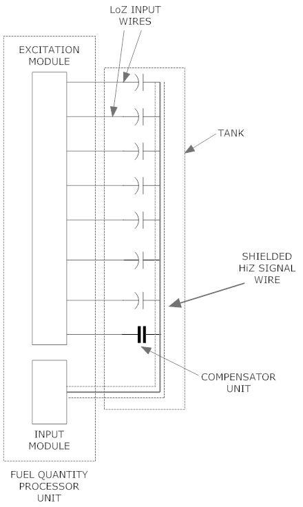

The 767's (and from what I've seen, the 757 also) uses a somewhat different approach for obtaining fuel levels than most conventional fuel quantity measuring systems.
Aircraft such as the 727, older 737's, DC-9's, DC-10's, and A300 use a total of three wires (tank to processor/indicator) for tank measurement. The tank probes are combined at the tank spar plug and only LoZ, HiZ, and Comp wires are needed beyond the tank itself.
Each individual probe on a 767/757 has its own LoZ input excitation wire. The HiZ output wires are all connected together. This does include the compensator output signal.
The fuel quantity processor unit looks at each probe separately by using millisecond "shots" down each LoZ wire. Only one probe receives excitation at a time, so the output HiZ signal can be measured for just that probe alone.
If a probe is lost, the processor uses a "sister probe" method for estimating the missing probe's value.
The good thing about this approach is that faults can be isolated down to the exact probe vs using a breakout box for tank probe troubleshooting on the aircraft mentioned above. The bad thing though........ many more chances of wires breaking.

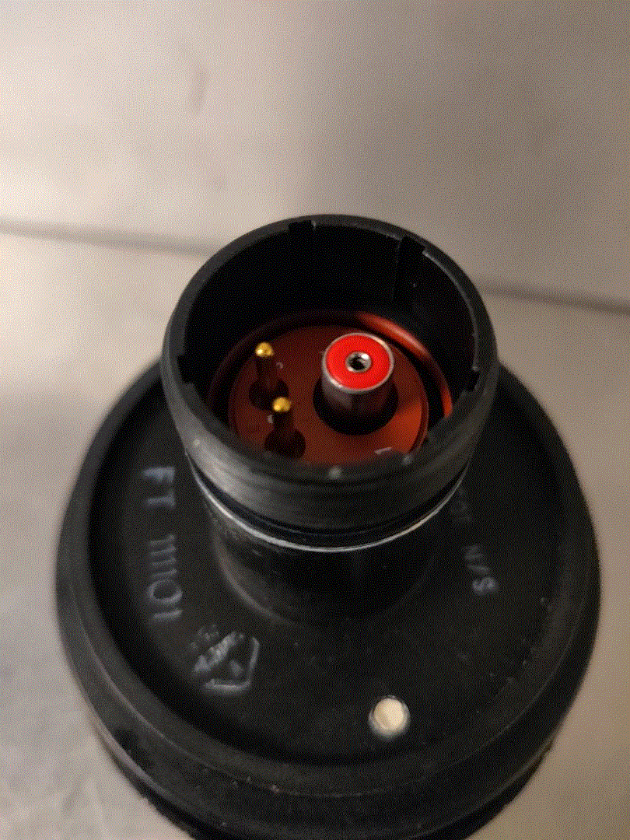

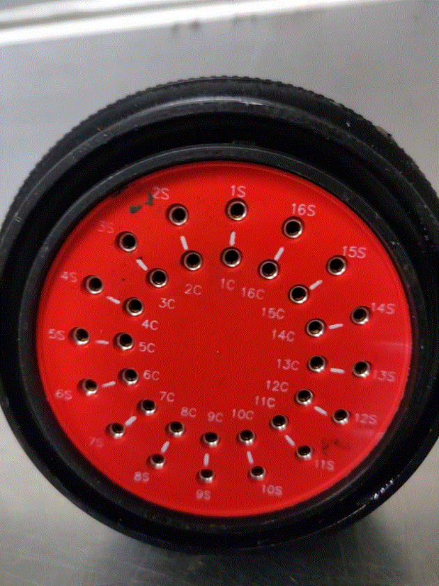

767 tank rear spar fuel quantity connectors and HiZ bussing plug.
The standard (from old 727, 737, and 747 days) three pin connectors are used. The LoZ and Comp pins are not used. The wider (shielded) HiZ pin is.
All LoZ and Comp wiring go through the upper plug.
As stated above..... more wires have advantages for usage (tank quantity reliability) and troubleshooting (isolation of single bad probe), but...... there is a whole bunch more crap that can break.

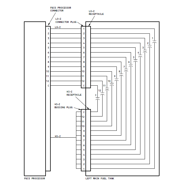

This is a better drawing than the one I have above.
Bussing plug for wing tank.
Location.

6 years 3 months ago #702 by Mark
Replied by Mark on topic ATA 28-41, Fuel Quantity
All tank probes are combined inside the bussing plug. Only HiZ, LoZ, and Compensator wiring go to the processor.
